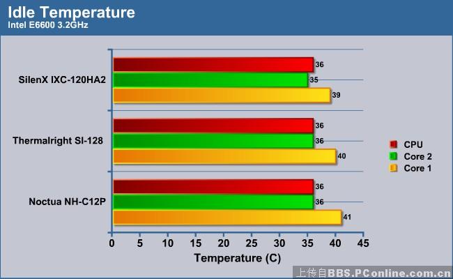

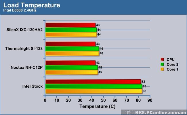

It is quite obvious that the retail Intel heatsink simply cannot compete with the aftermarket heatsink and fan.  At low level of heat output, all three heatsinks perform equally well with the SilenX ICX-120HA2 leading and Noctua NH-C12P taking the second place.  The performance is so close that it would be hard to say which one is clearly the winner.
零售Intel散热器仅仅不能同零配件市场散热器和风扇竞争是十分明显的。 在发热量的低的水平,全部3 个散热器用SilenX ICX-120HA-2 平等好执行主要和Noctua NH- C12P(替代第2 位置)。表现是接近,因而说哪一个清楚地是胜利者会是困难。

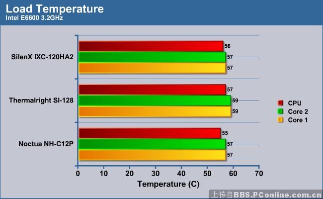

Once we overclock our processor to the 3.2GHz, we can see that the SilenX IXC-120HA2 actually is able to keep the CPU running cooler than the Noctua NH-C12P or ThermalRight SI-128 at idle.  The surprise comes when we look at the load temperature of the overclocked CPU, we see that Noctua actually is able to keep the CPU running at the same temperature as SilenX ICX-120HA2.  It is quite surprising to see the horizontal mounting cooler actually is able to perform at the same level as the vertical mounting cooler.  This shows that Noctua actually is able to conduct heat much more efficiently at high heat ouput than the SilenX ICX-120HA2 and it may attributed to the Noctua’s unique design of having the heat pipes extend to the base of the heatsink.
一经我们对 3.2GHz 的处理器超频, 我们能见到 SilenX IXC-120HA-2  实际上能够使处理器保持流动的比 Noctua NH-C12P 或者 ThermalRight SI-128 凉爽。  但当我们看被超频的处理器的负荷温度的时候,惊奇发现, 我们见到 Noctua NH-C12P与SilenX IXC-120HA-2  一般相同的温度使处理器保持流动比, 实际上见到水平的架设冷却器是相当令人惊讶能够在如同垂直的架设一般的水平冷却器运行。  这表示 Noctua 实际上能够引导热更加有效率地在高热 ouput 比较 SilenX ICX-120HA 2,可能归功于到 Noctua 的独特设计对 heatsink 的基础让热管扩充。
