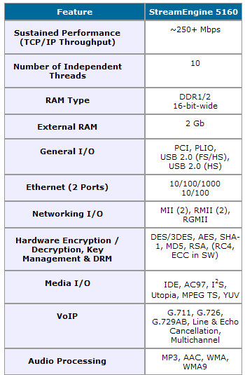

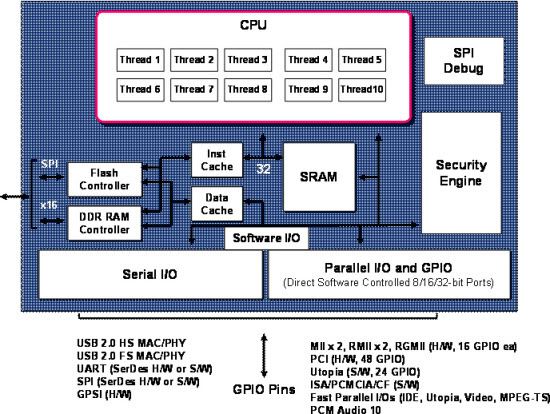

A key feature of IP51xx processors
The exact specifications of the IP5160U
