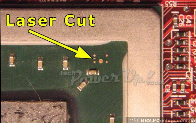

ATI's X800 Pro, X800 Pro VIVO and X800 XT PE cards are all based on the same GPU Chip - the R420. As you all know the Pro series has 12 rendering pipelines while the XT series has 16. It wouldn't be cost effective to make two versions of the R420 chip, so ATI is disabling 4 pipelines on the chip after production, just like on R300 and R350 before.

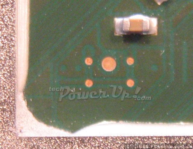

On the R3X0 cores ATI used a resistor - on R420 a laser cut as shown in the following picture:
X800 Pro VIVO cores do not have the laser cut:
The X850 Pro VIVO can be modded the same way, you just need another Bios.

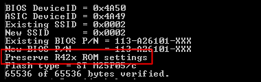

It is still running with only 12 Pipelines, even after flashing an XT Bios to it. The reason why the XT Bios does not unlock the additional pipelines can be found in the Flashrom flashing tool. It "preserves" certain ROM Bios settings when flashing another BIOS:
Several people have used a Gigabyte Bios and flashing tool to get around this, but for some reason you can not flash back to 12 pipelines with this method- if you have defective pipelines you keep them.
The method I present here uses a modified flashrom which does not preserve Bios settings.

Instead of the modified flashrom you can also use ATI's atiflash 3.xx. Just add -newbios to the command-line switches to disable "Preserve BIOS settings".

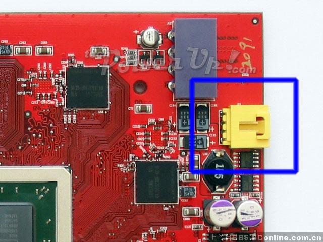

All VIVO cards can be identified by this yellow CD-Audio connector near the power plug. If your card has not got this connector, it is not VIVO and can not be modded.
